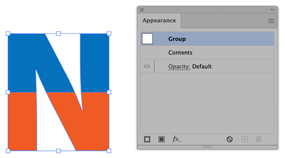

Do not add the stroke directly to the lettering, or remove it if you have already done so. Select all the parts of the letters and group them, and keep selected. Open the Appearance panel (Window menu > Appearance).
Click at the top where it says Group:

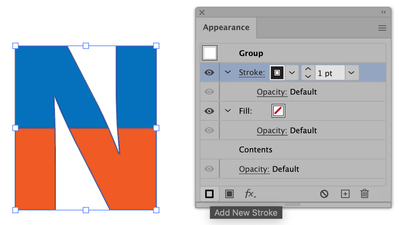

Then click the lower left icon to add a stroke:
Click and drag the new stroke below the Contents level:
then select the color and adjust the stroke weight. Half of the stroke will be hidden behind the fill, so double whatever stroke you want t
then select the color and adjust the stroke weight. Half of the stroke will be hidden behind the fill, so double whatever stroke you want to show:
