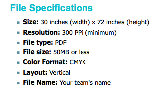

to Monica Gause: No I don't, I use vector graphics. But I am confused by the Requirements.
to John Mensinger/Test Screen Name: So If i save it as a simple PDF it is scalable ? Would be nice.
to jdanek: These are the specifications for the file I have to send. They don't say more than this.
Okay, as a conclusion: I can save my vector graphics as a PDF and they are scalable for them to the right size of 72x30 inches ?

Yes, vector graphics are scalable. Some effects have a resolution, so you should set that. Otherwise, you just create your PDF at the size (in inches) needed. Don't try to set any value in pixels ANYWHERE in Illustrator, even though it lets you! Make sure you designed in CMYK. In an ideal world, they will tell you WHICH CMYK PROFILE to use, otherwise your colours could be wildly off.
If you add raster graphics they will need to have an EFFECTIVE resolution to meet their needs. But if you don't, you can ignore that requirement.
