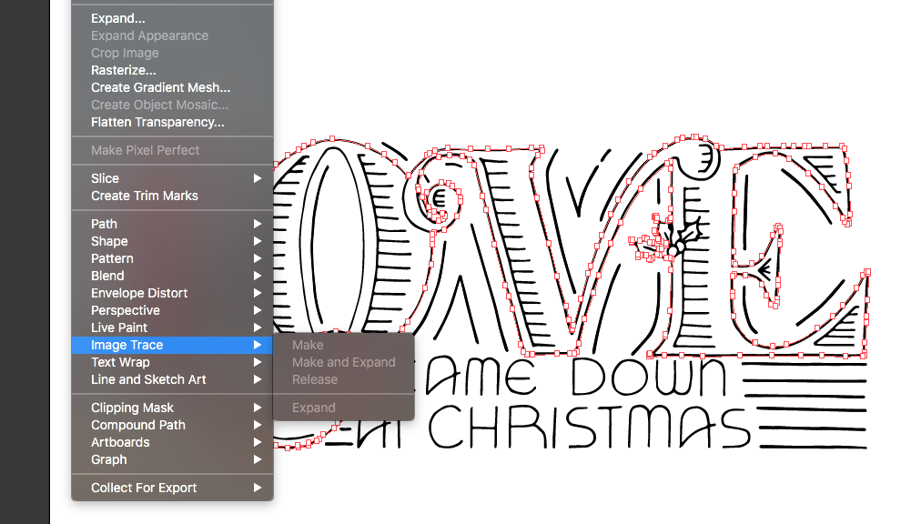

I imported my design into Illustrator to vectorize it. My challenge is, my letters overlap and I can't work on them individually. Ungrouping them the standard way won't work because they were designed together as is.
Do you have any suggestions?
Thank you!

Expand is unavailable when I have the shape selected. Any thoughts?

Yes, but my letter shapes are still connected and I can't edit them individually. I must be missing something.

It originated as an inked drawing and I imported it with Capture to vectorize it. I applied an Image Trace to it already. Does that mean I'm left using the pen tool?
I wanted to add color, but at this point it will obviously fill more than one area.

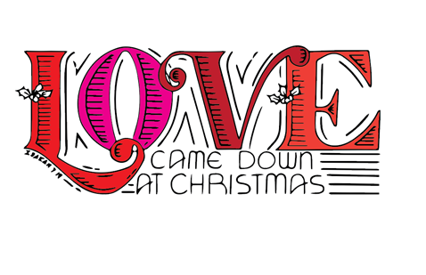

I copied your image into illustrator from the post above
applied image trace
expanded lines and fills
was able to select individual letters and color as needed. (see results at bottom)
*You might want to start with just the scan/jpg to image trace. Your nodes in screenshot above seem to show that only the outer lines of the letters were traced. See yellow area below.

True, after live image trace Make+Expand you can select the filled areas with the direct select tool and edit them ( the fills will be white)

I'm still not figuring this thing out. The image was vectorized with Capture, I've tried using "cut path" and I still can't edit one portion at a time.
I can't even do what @maxwithdax did above!
I still have the same issue as seen in the pic. Bummer!

Check out this video I threw together regarding your image. It should shed some light on what you might be missing and a few things you can do to clean it up. As always, there are 10 different ways to do anything in Adobe programs, so the way I did it in this video is just one way. But at least it should point you in the right direction.
How to Image trace a simple logo - YouTube
- Dax
