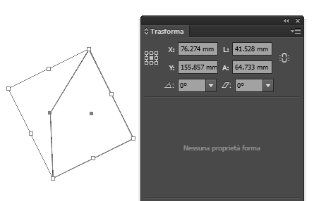

I've rotated an object. How can I see how much the object has been rotated? In other words, how can I know by selecting an object how much this object has been rotated?figura.PNG

Yes, but I can see how much has been rotated just in case the figure is a rectangle (in the Trasform Panel/Rectangle properties). Otherwise the rotation value is always set to zero.

In your example I can see the rotation, does not need to be a shape.

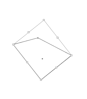

that's weird, in my case it's still zero. Maybe is there some option to activate?Cattura.PNG
Feb 04, 2020 Feb 04, 2020
"that's weird, in my case it's still zero. Maybe is there some option to activate?"
Can't think of an option.
The only way I can get it to zero is by resetting the Bounding box.
