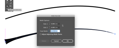

I think you would be better off drawing a new path for the stem and/or creating a brush for it. A fairly easy way is to create a stroked (no fill) path down the center of the leaf, and extending past it for the stem, with the Pen Tool. Then select the Width Tool and click and drag anywhere along the path, and in as many places as you like, to adjust the width of the stroke. You may also double-click anywhere on the path to open a dialog box in which you may enter values you might prefer fo the width of the whole stroke or for either or both sides of the path. In this example I've set the stroke width at the extreme right at 0.
Peter
