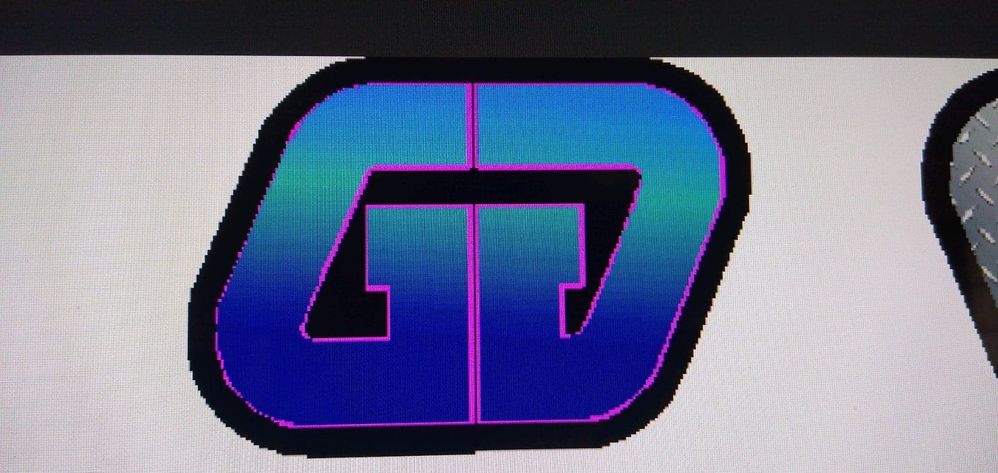

Not sure of the terminology here, but I created this on a crappy sign program at work...trying to recreate it on my Illustrator at Home....just the black contour, not worried about the pink outline. Helpabrotherout?

Doing that overlaps the two characters

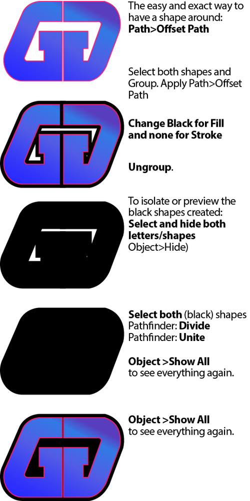

You can:
1) Create a stroke/nofill rectangle with a width as the distance between corresponding (unrounded) corners and the height, then round the corners, then shear it to the desired angle (you can use Object>Transform>Shear);
2) Object>Path>Offset Path with the offset that gives you a path at the middle of the thick outer black shape, then increase the Stroke Weight as desired;
3) Create two rectangles and cut them out of the sheared rectangle from 1) (you can use Pathfinder>Minus front or Shapebuilder);
4) Select everything and Object>Path>Outline Stroke to get filled paths, then if desired add a (pink) Stroke.

FEDERICO, I LOVE YOU!!!!!!
Thank you so very much, sir....I have struggled with this for weeks..... I knew what I wanted was achievable but I couldn't make it happen....thank you again
