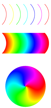

For my part you are welcome, Ludo.
As you can see, it is doubly twirly, reversely near the centre. You may try different ways of curving, including (multiply) reversed curvatures of different shapes/lengths (as in the (different) rounded version(s) of Sowelu (limited to mirrored shapes)).
I hope you will share you findings, for everyone to enjoy.

You need to create a bounding box for that brush which marks its begin and end. This rectangle has to be no fill and no stroke put in the back. Then create a brush.
Jul 22, 2013 Jul 22, 2013
Ludo,
Step 7) in post #10 is crucial:
7) Create a nofill/nostroke rectangle with the same height as the curved paths and a length equalling the total move and place it centrally behind the blend (which will overhang it at both ends;
Otherwise, the Art Brush will end where the outermost curved paths end. You can draw a line from the centre through those ends when applied to the circle, and that is what creates the gap.
So it seems that you have missed that step, which is basically identical to the suggestion that Monika made.
To avoid a smiling, or (almost literally) gaping swirl.
