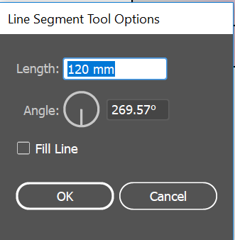

Hello!
I want to quickly draw irregularly shaped boxes. The boxes have to have lines which are at an exact length. How can I do this the easiest way? Thanks!

Hi there,
Thanks for reaching out. Please try these steps and let us know how it goes:
  • With Pen tool you may create line and adjust length from Properties panel.
  • It's much easier to do with the Line tool. Double click on Artboard with Line tool selected and enter the length you require.
  • Then you may duplicate the line by ALT Drag.
Srishti

Elias,
To elaborate on the exquisite Line Tool suggestion by Srishti, you have different options for building the boxes, depending on the need, Smart Guides being your friends (when used below they say anchor or intersection when you are within snapping distance).
For a(n initially) freeform build, you can Alt/OptionDrag the new copy line by the appropriate end Anchor Point to snap to the desired end Anchor Point on the original/former line, then switch to the Rotation Tool and click the point again to set it as the rotation centre, then ClickDrag by the other end as desired.
For a build with (mostly) specific angles, you can just Click the Artboard with the Line Tool for each line and set the angle (leaving the length as is), then ClickDrag the lines to snap.
Either way, to end up with the exact same length on the last two lines, I am afraid you will need to use circles as follows: create two circles with twice the length as width/height and centre them on the end Anchor Points to be joined with the two lines, then ClickDrag with the Line Tool to snap (either way).
And in the end, you need to join the lines into one closed path, of course.
