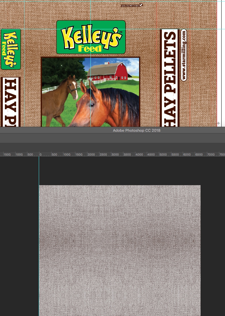

Original was a CMYK PSD file (see AI part of screenshot)
Actual file is a renamed Monotone PSD (see PS screen) Both were/are the same size and resolution. AI is still using the lo-res placement of the CMYK version.background.jpeg
Bug with monotone images?

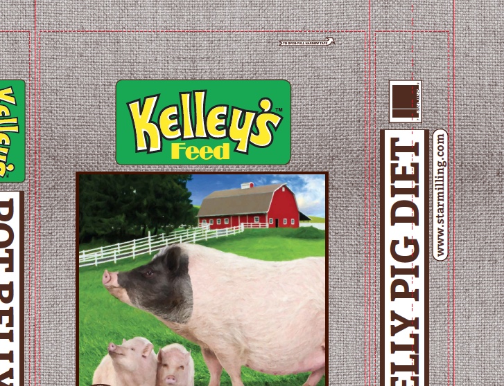

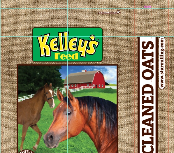

Now see that it's a weird display issue. Both these two docs below are the same CMYK build, and both had the background images replaced from the links palette. One displays as it should, the other - heavily colorized on screen.
Probably need to take this to another thread, but I figured I should follow up here.
Not correct display of monotone PSD:
Correct display:
