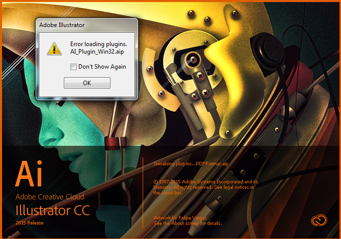

I am getting a warning message when starting Illustrator after my plugin creation in path (C:\Program Files\Adobe\Adobe Illustrator CC 2015\Plug-ins), Please check the attached  image file .
Please help me to display my plugin in Illustrator menu.

Looks like you have built a Win32 version of the plugin. You need to build a 64 bit (x64) version.

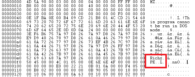

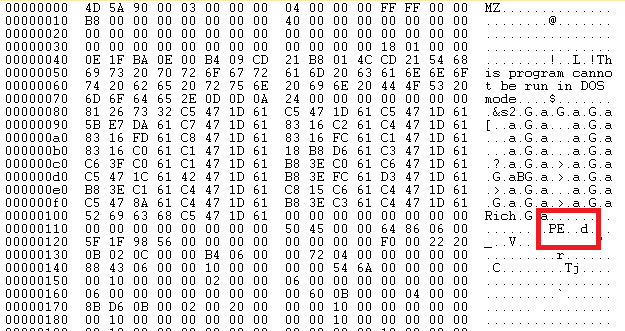

Have you built a 32 bit version before? Are you sure you have the 64 bit version in the plugins folder?
In Visual Studio, do File | Open | File (Ctrl + O) and open C:\Program Files\Adobe\Adobe Illustrator CC 2015\Plug-ins\AI_Plugin_Win32.aip
It should open as a binary file, with hexadecimal values and character values to the right. About 16-18 lines down in the character values you should see "PE..L" or "PE..d". "PE..L" means 32 bit and "PE..d" means 64 bit, e.g.
MPSExport.aip 32 bit:
MPSExport.aip 64 bit:

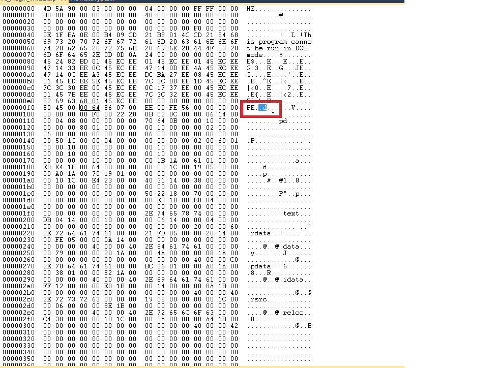

Engaged ,
Apr 01, 2016 Apr 01, 2016
Yes I am sure It's 64 bit version
Please check in attechment file
