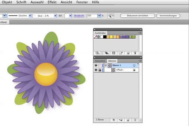

You can add multiple outlines, multiple fills and/or effects to any or all of these. Note that some effects will need rasterisation and the artwork can uickly become very complex. By expanding appearance you can then split the creatied shapes into simpler components if you need to tweak them. (This is a video of @Monica Gause creating artwork just using one point and the appearance pannel… just to inspire you with the potential https://vimeo.com/20576596)
Eigentlich ist diese Blüte nichts Besonderes ... bis auf die Tatsache, dass sie aus nur einem einzigen Ankerpunkt besteht.

Guy uses too many shapes in that example. An anchor point would be fully sufficient 🙂
