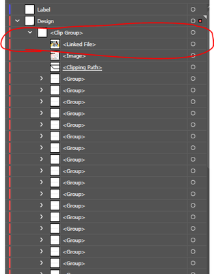

Yes, heres the panel shot. Well, I did something  like you said, (i think?) and this happened! Does the picture need to be linked' to the one above it to work maybe?
Dec 21, 2021 Dec 21, 2021
The underlined item (Clipping Path) is acting to 'clip' everything in the clip group.
You need to add your image to that clip group. You can simply drag it into it in the panel.
