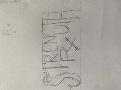

Hi all 🙂
I am trying to achieve this arc (refer to very rough sketch) but have the text stretch and fill the available space. I attempted to have the text fill a shape but it came out all warped. Anybody know how I can do this?

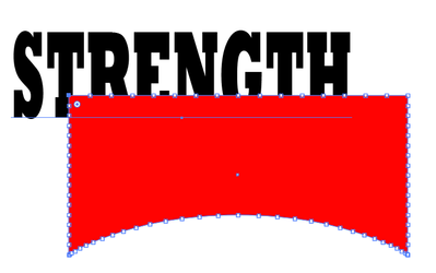

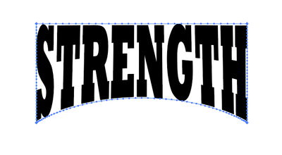

I personally do not like the distortion seen mostly on first and last letter. So now we get into a complex issue with illustrator. Make a red shape as shown and  use Object >> add anchor point serveral times on the red shape.
Then Object >> envelope Distort >> Make with top object.
The red disapperas, I just use any color but black to confirm what is on top.

The issue of dsitortion has to do with how the shapes end result looks same, but looking at handles you can see is different.
You can see the difference here
You can add an extra point to top middle and pull handles to improve distortion.  Going back & forth you may get a decent result, but the add anchor points technique seems to help best. Anyone else have suggestions about distortion, please add to this as curious how others deal with this struggle.
A long time ago we had a Torries wheel that did this photographically where the art was exposed while the Torries wheel changed direction. While that wasted lots of film and chemicals and a large darkroom, but it seems to give a more uniform result.
