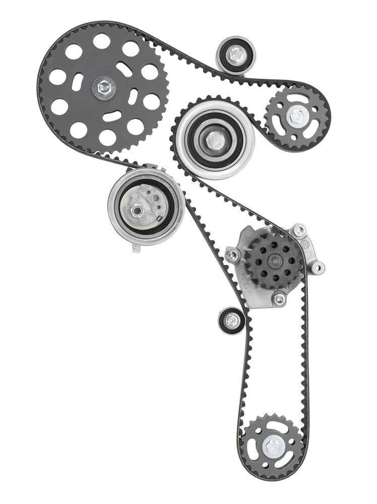

I have to make a technical illustration in Illustrator. It should show the main drive of a car. That means some cogs driven by a toothed belt. But how to design cogs with rounded teeth? All descriptions and tutorials show solutions using circles and stars – but the outcome always contains sharp edges. In my illustration the cogs have to have round edges (like the cogs of a bicycle).

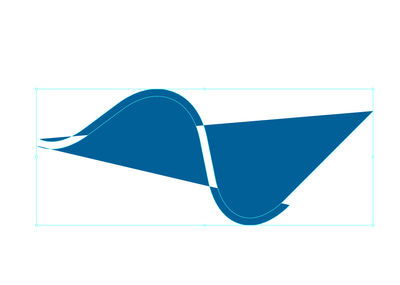

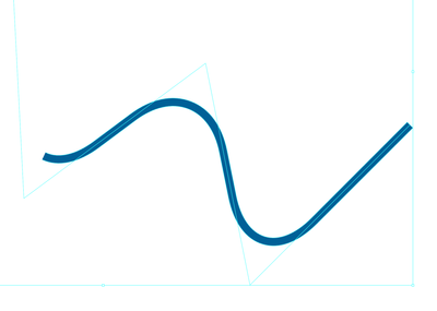

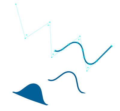

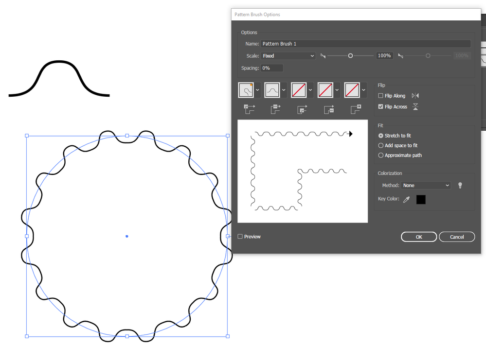

The best way is probably to create a pattern brush from something similar to the path at the top. Then you can fine-tune the shape:

Hi Doug, thanks a lot. I'll try that.

Hi Doug! But how I get the "little wave segment" to the circle?

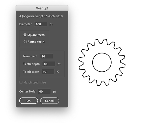

This may also be useful for creating gears:
When looking for a script I stumbled upon this gear script from Jongware, the Gyro Gearloose of scripting.
It was mentioned here: https://community.adobe.com/t5/indesign/scriptui-for-dummies/m-p/2970630?page=2
You can download it from his web site: http://www.jongware.com/binaries/gearup.zip

The script is very user-friendly. It simply opens a dialog window where you can set the parameters of your gear.
Sep 15, 2020 Sep 15, 2020
Andreas, like Doug said, it is very easy to use.
Either install the script ( https://helpx.adobe.com/illustrator/using/automation-scripts.html )
or just select it from File > Scripts > Other Script...

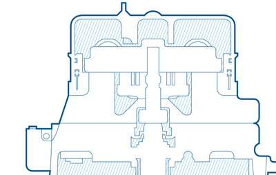

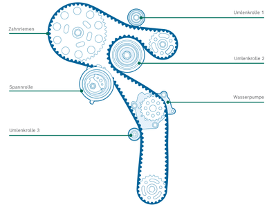

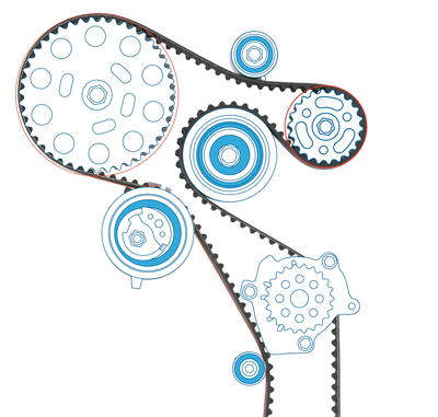

Hi you guys, thanks a lot for your support. The drawing is making progress. The components are nearly done. Just the toothed belt is missing (see the attachment). But ... there is one more thing: As you see in the other attachment – showing a part of a pump – there is this "line structure" (German: "Schraffur"). How do I do that?
Sep 16, 2020 Sep 16, 2020
I assume the tooths of that belt should not be distorted. You could use a combination of a scatter brush (Spezialpinsel) and a simple stroke to create it. Apply two strokes in the appearance panel for that.
As for the Schraffur: use a pattern. You can create a horizontally striped pattern with the pattern editing mode, then apply it and rotate it when it's applied to the shape.

Hi Monika, das mit dem "Zahnriemen" kriege ich hin. Das mache ich einfach "von Hand" und setze die "Zähne" einzeln drauf. Ich habe ja die kleinen "Halbkreise" aus den Zahnrädern. Wo der "Zahnriemen" hinter dem Zahnrad liegt, sind die Zähne schon da.

Schnittmenge hat geklappt, Monika. Vielen Dank. Jetzt müsste ich die "Nasen" des "Zahnriemens" konstruieren. Ich dachte, ich nehme einfach den "Zwischenraum" zwischen 2 Zähnen des Zahnrads. Da pirsche ich mich jetzt heran (siehe 2 Bilder im Anhang). Aber beim Löschen der letzten Ankerpunkte "schnappt das ganze rüber" und ändert die Form. Mmmh, was meinst du?

Hi you guys, thank you so much for your professional and patient support. As attached the illustration was sent to the customer. So, let's see. Bye bye and stay healthy until the next thing. Greetings from Stuttgart.
