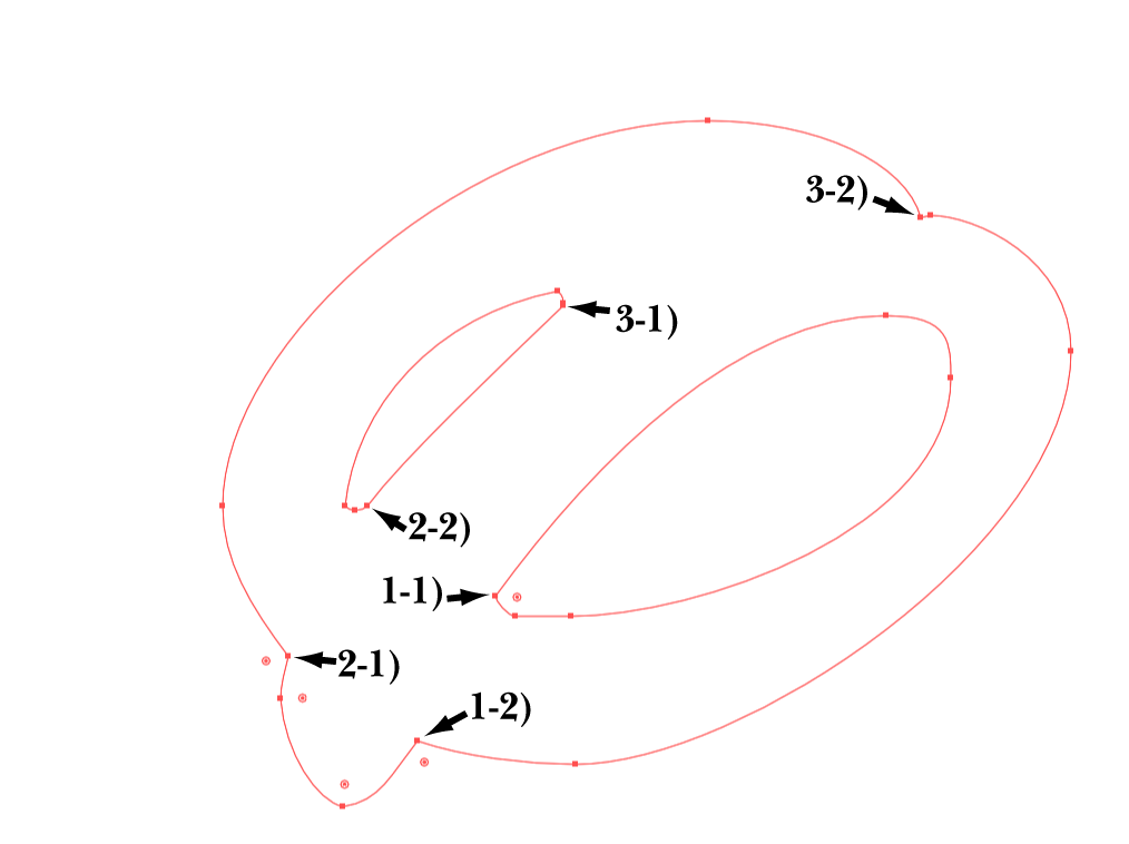

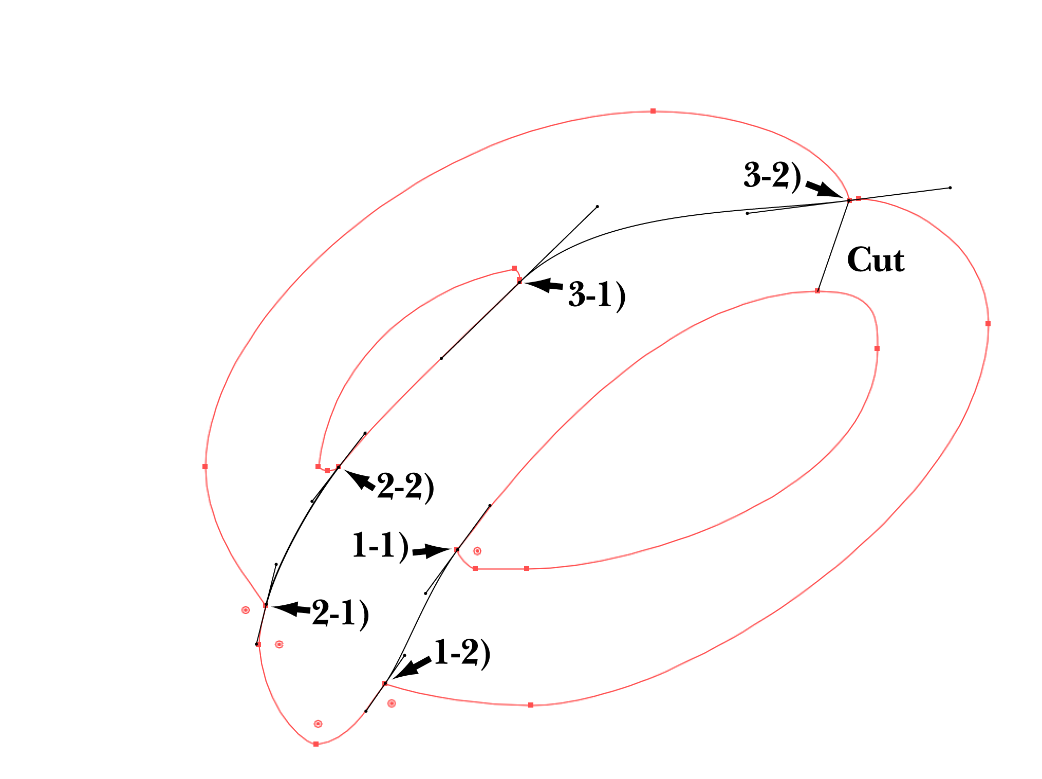

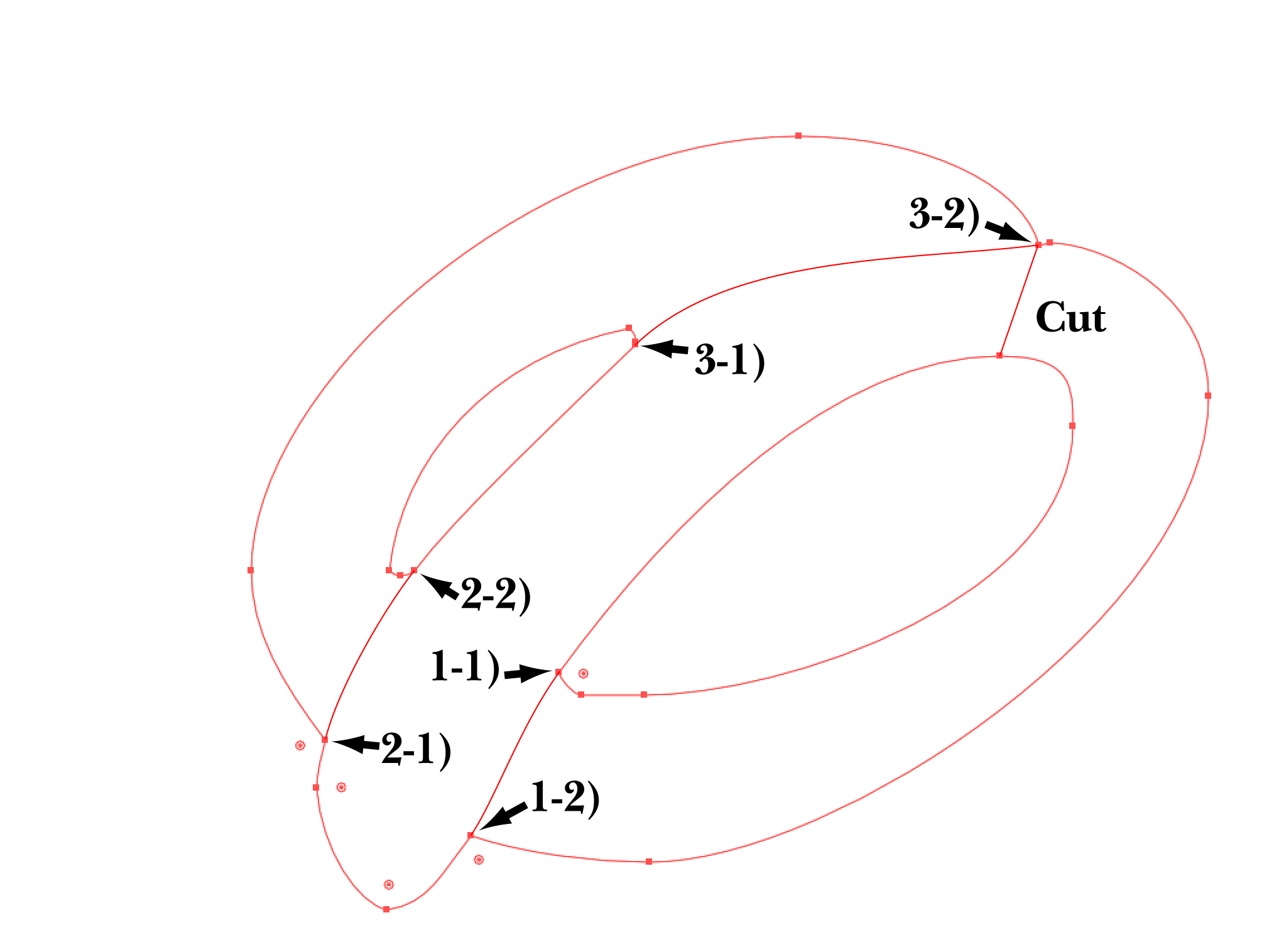

Calai,
You can do it in a fully accurate way corresponding to my W reply.
But Referring to your screenshot with markings below, you can also do it in a coarser/simplified way as follows, still with unchanged unchanged visible parts of the original path, based on drawing by eye with the Pen Tool, Smart Guides being your friends:
First copy your i dot twice on top of itself and lock and hide the original and the first copy, and work on the second copy;
Then with the Pen Tool Click on the outside and the inside of the top right curve of the i dot path where you wish to cut it to start the dash (Smart Guides say path when you are within snapping distance, and you can move the points back and forth until you are satisfied), and then use ObjectPath>Divide Objects Below;
Now you have cut the path which remains closed with straight segments between the two new Anchor Points; this corresponds to steps 2) - 3) in my W reply;
Then with the Scissors Tool, move the cursor to each of the points, 1-1), 1-2), 2-1), 2.2), 3-1), 3-2) where Smart Guides say anchor when you are within snapping distance, make sure you snap to the bottommost of the two Anchorpoints at 3-1);
Now you have cut up the copy path; this corresponds to step 4) in my W reply;
Then with the (normal) Selection Tool select the handle parts and leave the dash part; this corresponds to step 5) in my W reply;
Then draw the curved part from 1-1) to 1-2):
  1. With the Pen Tool Click to snap to 1-1 (Smart Guides say anchor when you are within snapping distance), then ClickDrag down to the left so that the opposite mirrored Handle to the top right follows the direction of the existing curve, and so that the Handle length is about one third of the distance to 1-2),
  2. Repeat 1. only with 1-2), where you ClickDrag down to the left so that the Handle you are dragging out to the bottom left follows the direction of the existing curve;
Then draw the curved parts from 2-1) to 2-2) in the same way;
Then draw the curved parts from 3-1) to 3-2) in the same way, make sure that you snap to ;
These three steps correspond to corresponds to steps 6) - 10) in my W reply;
Now you have the dash drawn by eye;
Then switch from Stroke to Fill and give the dash its colour; this corresponds to step 11) in my W reply;
Then Show and Unlock the first copy of the i dot path, and switch from Stroke to (black) Fill; this corresponds to step 12) in my W reply;
Now you can see what it looks like;
Then select both paths and use Minus front (Pathfinder); this also corresponds to step 12) in my W reply.
