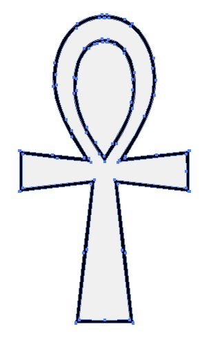

I have an SVG file of a shape that I need to fill and then import into Photoshop. The oval part at the top needs to be cut out (transparent). If I select the entire shape and choose a black fill, the entire shape including the oval, is filled with black. I tried a tip I found in the forum (Object - compound path - make), but it didn't work. Is it because the outlines of the shape are two paths instead of just one? Or because the file is an SVG file and not a native Illustrator file? As a workaround I could rasterize it in Photoshop and do the cutting and filling there, but I would like to know how to do it in Illustrator.

You're correct about the outline.
What you could do:
Select all, take the Live paint tool and click inside the object. Then select a fill of "None" and click into the area that needs to cut out.
Then you can expand the thing. Illustrator will take care of it.

This was a big help - I got it to a state where the hole is cut out. I can't fill the rest of the shape, but I can do that in Photoshop. Thanks for your help!

Select all:
click with the Shape builder tool to make shapes
Alt click with the Shape builder tool to punch a hole, or remove lines
Go back to the  selection tool to assign fill colours

Nothing wrong in making good old simple ways work.
It may be a matter of path direction, so you could reverse one of them.
But it is easier to just Pathfinder>Minus front if the one to be the hole is at the top, or Pathfinder>Minus back if the one to be the hole is at the bottom.

I already altered the original file with the information provided by Monika Gause, so I can't go back and try the Pathfinder method. I'll keep it in mind for future projects though. Thanks!
