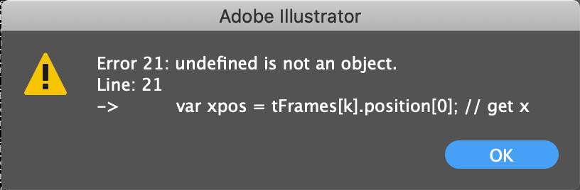

Community Beginner ,
Nov 06, 2019 Nov 06, 2019
Carlos, I tried the updated script, and got the error below. Thank you for the time you're putting into this, I can't believe you've been answering this question for eight years. That's some serious patience and tenacity.
@neilb69570407, Were you able to get the script to run successfully?
Nov 08, 2019 Nov 08, 2019
Hi ahablett, 8 years and counting 🙂
the new forum migration really messed up with the arrays. I'll re-post the original script in a separate response so it doesn't get buried in this thread.
here's the re-post of the Split Words into Characters script
