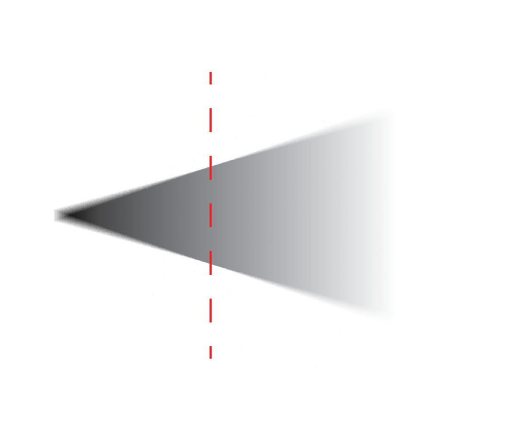

Community Expert , Jan 16, 2025 Jan 16, 2025
radial blur, set up like this?
Bildschirmfoto 2025-01-16 um 10.46.12.pngBildschirmfoto 2025-01-16 um 10.46.19.png
But if that is not what you are looking for, then take a look at the options named above.

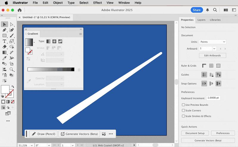

The demo below is only one of the many ways to do it, but it’s a method I use a lot.
It just applies a linear gradient fill. At one end, the gradient stop Opacity is set to 0% so that it fades out to transparent at that end, to blend in with the colors behind it. The command Effect > Stylize > Feather is applied to soften the edges. The quality of the gradient in the demo is a little rougher than in reality because something about the Adobe forum software degrades animated GIF uploads.

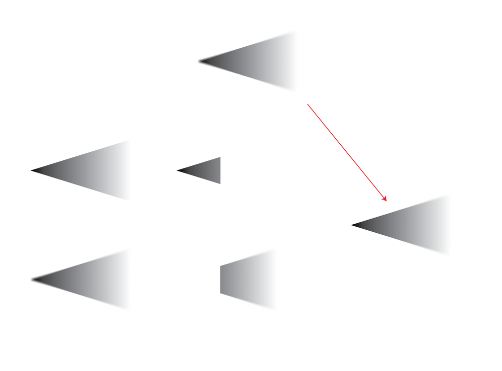

Excellent suggestion! Thank you! Your solution is indeed much simpler than mine. By duplicating the shape and using a clipping mask at the middle of the Radial Blur to reveal the beginning on one shape and the end on the other, it works perfectly!
Although it would be ideal to create this effect using only one shape, this approach works great for now, and I’ll definitely use it.
Thanks again for your help!
I did not use a mask in mine. You can move the center of the blur in the dialog box.
