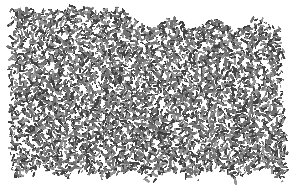

I use Symbols heavily to draw heavily-repeated objects on boardgame maps. It's a common piece of advice to do that, since Symbols can reduce file size. However, I'm not so sure about that.
Below is a screen shot of a section of Rubble. It's basically a Scatter Brush that throws the same Rubble symbol around, scaling and coloring and rotating it. (Actually, no - it's two separate Rubble brushes, each of which uses a different colored symbol, because the Scatter Brush doesn't know how to change symbol tints. But as much as I wish Adobe would fix that, there's ways around that, no worries).
So, the version of this done with a Scatter Brush is 2211 Kb. If I expand the brush to create a ton of small bits of individually-filled Rubble paths (deleting the bounding box that got put around each Symbol as it was expanded), the file size goes to 1805 Kb. Huh? I thought Symbols were supposed to be more efficient than Paths?
Then, if I make a Symbol out of an individual bit of rubble (just one of those blobs you see above) and use the wonderful Copy To Multiple Objects script, I can replace all of those individual rubble bits with a rubble symbol. THAT file size is 2527 Kb.
So... what's up here? I thought Symbols were supposed to be more efficient for this kind of thing.

Tom,
Apologizing for a possibly silly question, are you setting it to be a Dynamic or Static Symbol, the latter being the one to better save file size?

Don't understand what you're doing there.
Symbols can't be inside brushes. So what is this?
Also: of course you can apply color tints to scatter brushes.
And then: are you sure it's the same number of objects when you use symbols compared to brushes?
How do you save the files? Exact options, please.

My apologies, Monika. Yes, that's not a symbol that I used in a the scatter brush, it was just a small path (one of the "bits" of Rubble, basically a rough-edged rectangle. No "roughen" was used on the path)
You're also right about being able to apply color tints to scatter brushes - but it's not one of the Random features. The entire brush has to scatter the same-tint of shape. No big deal; one can use the Random Swatches Fill script to select all the shapes and randomly tint them using a given subset of swatches.
I save the files as .ai files with no pdf compatibility, but with compression. I do not recall if I embed ICC profiles - doubt it.

Jun 11, 2019 Jun 11, 2019
After drawing with the brush do you expand the appearance in order to run the script?
After drawing symbols - do you unlink the symbol instances?
Do you use the symbol stainer tool? The manual tells you it will increase file size: Symbolism tools and symbol sets in Illustrator
Yes
I don't draw the symbols, as you helped me realize. After I expand the brush to create a ton of paths and delete the bounding boxes around each path, I then use the Copy to Multiple script to replace each path with a symbol. At that point, no, I do not unlink the symbols. Saving that file is 2527Kb in size, as I explained above. If I select all the symbols and break the links, then collect all the resulting paths into the same level and save, THAT file is 1812 Kb. Which has me even more confused.
No. I find the symbol stainer/scatterer/xyz-er tool to be way too unintuitive and uncontrollable. Even for this application where all I want to end up with is a big mass of shapes, I have more control with Scatter Brushes.

Tom,
ANNND we have a winner!  Yes, I was using a Dynamic symbol. Selecting the Symbol Properties and changing it to a Static symbol, then saving, the file size becomes 293Kb, much less than any of the other options I tried.
