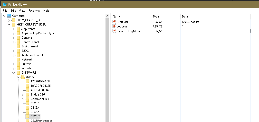

I set PlayerDebugMode to 1.Please see the image given below.
I set the Service Manager Root Folder to C:\Program Files\Adobe\Adobe Illustrator CC 2015.3\CEP\ but the problem is not solved.

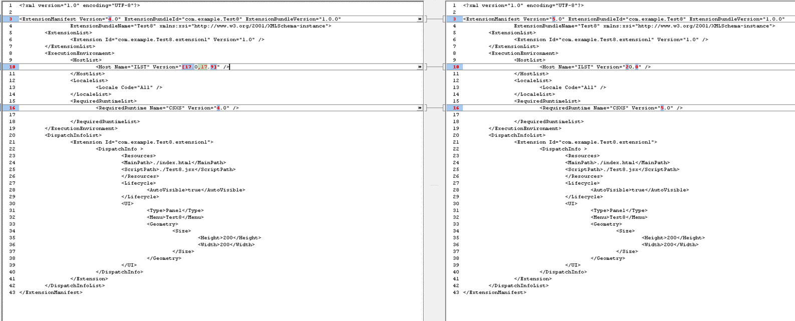

Then I am surprised that there an CSXS\manifest.xml exist in the extracted zip File.
Then I add a new Folder CSXS and and new file manifest.xml and copy the content of manifest.xml from extracted zip.
Then changed the following
Service manager root direcory:
Target Illustrator: CC 2015.3
And
<Host Name="ILST" Version="18.0" />
<RequiredRuntime Name="CSXS" Version="5.0" />
as given in Illustrator 2015.3 SDK Sample UI projects.
Then I export the project as zxp and Install by using Anastasiy’s Extension Manager.
My extension is shown in Window>Extenstions menu in Illustrator CC 2015.3.

The Manifest.xml file in the Sample UI Projects of Illustrator (CC2015.3 and CC 2017) has the value ,Like below
<Host Name="ILST" Version="18.0"/>.
So Only I used Version="18.0".
If I use <Host Name="ILST" Version="18.0"/>.
Then extension is installed in Adobe illustrator Versions CC2014 And CC 2015.3.
else if I use <Host Name="ILST" Version="20.0"/>.
Then extension is installed in Adobe illustrator CC 2015.3 only.
Now i'm Understood that Version="20.0" is the Correct choice For Illustrator CC 2015.3.

Dear Friend,
Thank you for your immediate reply and suggestion.
I try the compare method as you said,and found that The problem is ILST Version automatically changed at the time of Debugging.I think this is the problem.
When I am trying Debug As Adobe Illustrator extension then ILST version automatically changed like below
<Host Name="ILST" Version="[17.0,17.9]" />
But Exporting ZXP contains a manifest.html in that file the ILST" Version="20.0" /> which is Same as I Wrote in code(manifest.html).
please see the comparision given below
please give your suggestion how to solved this problem.
Thank you Friend,
Nathan.
Copy link to clipboard
Copied
Follow Step 3 to edit the manifest.xml in your extension builder project:
Copied
Dear Friend,
Thank you for your Suggestion.
I edit manifest.xml and now the extension in shown at the Debugging time,
regards,
Nathan.

hi ,
My Extension do not show when i debug in Illustrator 2017. How did you made it?I have tried many solutions,but did not work. Please help me
thank you so much.
Copied
Dear Friend,
Have you set the Following
1)Service Manager Root Directory as C:\Program Files\Adobe\Adobe Illustrator CC 2017\CEP
2)Target Application as C:\Program Files\Adobe\Adobe Illustrator CC 2017\Support Files\Contents\Windows\Illustrator.exe
3)PlayerDebugMode=1;
If You Already set the above Correctly.
Then The problem is the manifest.xml file
Follow Step 3 in the below link to edit the manifest.xml in your extension builder project:
Adobe Extension Builder and Creative Cloud 2014
set The ILST Version as 21 For CC 2017.
Thank you Friend,
Nathan.
