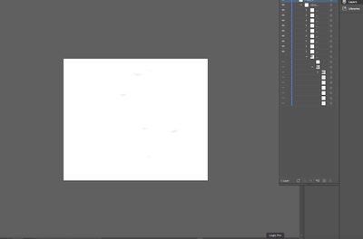

Explorer ,
Apr 26, 2022 Apr 26, 2022
  So I think I managed to remove the squares although now I have one large white square now !? which I cannot seem to remove. Im still trying to fathom how to remove the grey background now so I end up with a transparent layer of clouds and nothing behind them
Looks good!
The square is the artboard.
Take the artboard tool and enlarge it, so that it covers all the clouds you want to use. That is important for importing the artwork into a different application or for printing.
The artboard looks white, but in fact is transparent.
Since you won't be able to see the clouds on a white artboard, you can turn on the transparency grid.
Explorer ,
OK â€ƒso I resized the white artboard as you said, and I can just about make out the clouds due to the subtle shadows.  So am I now able to export this as a transparent PNG file to be able to reimport into photoshop are are there more stages to go ?
You could export this as a transparent PNG (PNG 24)
Or you could even export it as a PSD (keeping main layers - which might or might not work, depending on the details)
Alternatively: Place the AI file in Photoshop as a Smart Object.
Whichever seems most appropriate for your workflow.
