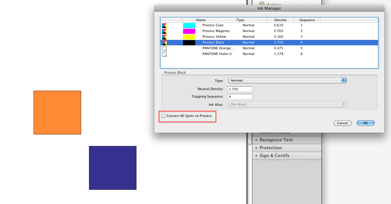

When you export the pdf, what are you color settings? No Color Conversion will retain your colors as Pantone spot colors.
Jul 28, 2014 Jul 28, 2014
The only one I can think of is in the Ink Manager dialog.
New Here ,
SRiegel Hey, I save pdf with no color conversation
Larry G. Schneider in InkManager, there are no Pantone colors shown
And there is one strange thing - I replaced one object's Pantone color with another but from the other Pantone color book, saved as usual and I see this color in InkManager. How is that possible? And as I understood typography handled it (replaced CMYK colors with Pantone I named)
