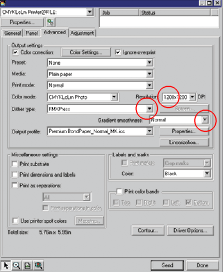

The gradients should hold up, what PDF preset are you using? Try High Quality , Pre press or PDF/X. Please post a screenshot of your pdf settings.
How much Ram do you have, and what are your computer specs?

Have never printed onto vinyl (except sending out files for trade show graphics) , but assume resolution is same as paper.  You are right vehicles graphics is broad, and was thinking auto with gradient and textures, not plane.
Is there an LPI setting. What settings did you use, would pay close attention to these settings?
