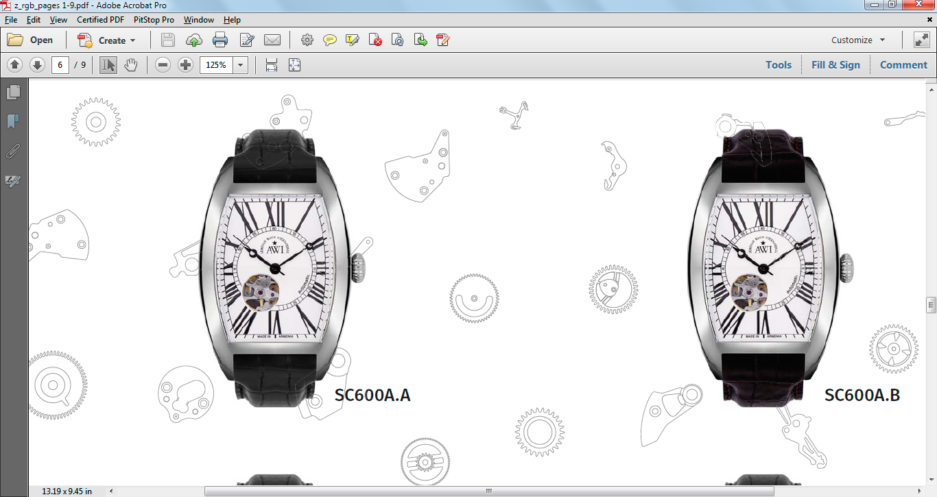

I'm using Illustrator 19.2.1 on a Windows 7.
It's a catalog, in an .AI file. It consists of artboards with vector backgrounds (small watch parts in strokes) and placed .TIFF images of watches (transparent at endings where there's no graphic). Both examples are shown in my attachments 1 and 2. And you can see the design in Illustrator in my 3rd attachment.
The issue: When I print the .AI to PDF (both high-res CMYK for the printhouse + mid-res RGB for the web version of the catalog), the flattening works in a way that the elements of the background (watch parts) show up on top the watch images. This is visible in my attachment 4 - the background elements are on the watch straps.
I've tried different settings, flattening and overprint options, converting the TIFFs to PSD, searched and studied forums, but nothing helped. Please help me to solve this issue. Any idea will be very appreciated!

I assume that those lines are not on top of the watch, it's just very bad stitching.

Guide ,
Jan 25, 2017 Jan 25, 2017
You can usually make the stitching lines vanish in Acrobat or Reader by changing your preferences to Page Display> Smooth line art (off). If you zoom in on the lines, and they don't get any bigger, that confirms they are stitching lines. They won't show up in your printed piece. Your printhouse requirement for a printed PDF (probably to force flattening) might be out of date, I would ask them. A PDF saved from Illustrator with layers and transparency intact would probably eliminate the stitching lines.

New Here ,
Thanks a lot!
I've tried the Acrobat's Preferences' "Page Display> Smooth line art (off)" trick and made even "Smooth Images (off)", and the unwanted elements disappeared! So I assume this is just a problem in rendering the document.
