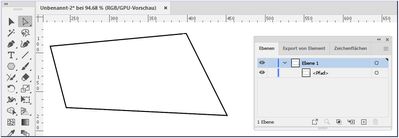

Community Expert , Feb 25, 2024 Feb 25, 2024
like this:
select and remove
choose the Join Tool
use at every corner
done

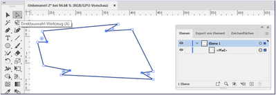

Maybe it will work for you:
  1. select only the "wrong inner" anchor points
  2. remove them
  3. use the join tool to create your new perfect corners
like this:
select and remove
use at every corner
done
