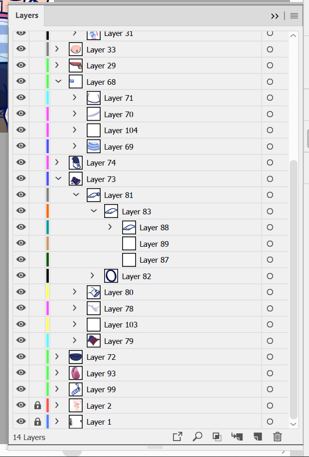

If you have the layers panel open and you select any object on the art board, the layer in which that selected object is in, will auto expand in the layers panel. Is there a way that it wont do that?

Thanks but that only hides the thumbnails and really doesn't help.
Let's say all my layers are collapsed. When I select an object that is within a sublayer, the layer expands to show the selected sublayer.
It's annoying when I have hundreds of sublayers within sublayers.

You probably don't have a layer within a layer (sublayer). You probably just put your Objects in the layers, and it only works in the sense that it doesn't expand your sublayers, but still expands the main layer holding the subs, which was my main issue.
To fully recreate my issue and see what I;m talking about do this:
Make 2 layers (Layer 1, Layer2) with a square in each of them.
drag and drop layer 2 into 1 and deselect everything make sure the layer is collapsed and chose the object that is in layer 2 and layer 1 will expand
Works the same way when using the proper "new sublayer" button in the bottom right of the layers panel.

This is exactly right, and incredibly annoying. It's related to when you 'Break Link to Symbol'.
I have a complex default .ai file with dozens of symbols rearranged, so that when I replace the main image in the symbol, it permeates the change to all of my artboards. But then, I need to break the link to all those symbols (causing a tidal wave of layers and sublayers) and then save-as before working with each individual project file.
My sub-layers do not 'normally' continuously open themselves on other .ais, but whenever I'm working with this file, this always happens. Its infuriating. Thank you for delving deeper and figuring this out, now I know that after I break link to symbol, I can immediately cut as well (since they're all selected) and paste into a new fresh layer, and delete the old layer. This will purge the 'bug' and I can continue work without the sub-layer issue.
And as the OP said above, when doing tricks like this, it's often hundreds of sublayers, so the moment the bug starts, the entire layer menu becomes worthless because it's constantly flooded out with a page of layers scrolling off the menu.
