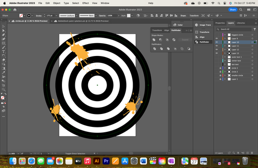

I'm having trouble masking drawn objects
Community Beginner ,
Oct 27, 2023 Oct 27, 2023
I've been doing research on how to add a paintbrush effect to a circle but can't really get a solid answer on how to do it, a lot of it seems to making objects into compound shapes and then uniting them but it makes what I drew disappear. In short how do I add the paintbrush effects onto the black circles like the second piece. I drew the second one on Procreate and the tool was 'Alpha Lock' but on Illustrator it's clipping mask?Screenshot 2023-10-27 at 5.40.19 PM.pngCircles with paint procreate.png

They were originally 2 circles from the elipse tool then I used the live paint tool to fill in the black, then I just made 1 circle and made the stroke 70pt.
The single 70pt stroked path is able to be made into a compound path but when I select the draw inside, the paint blobs appear on the outside. And when i use the other circle, I ungroup and try to make into a compound path but i get an error.

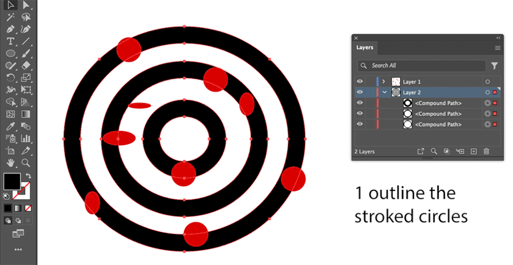

Outline the stroked circles.
Object > Compound Path > Make
When still selected: Click the Draw Inside button at the bottom right of the Toolbar.
Cut the paint blobs and choose: Edit > Paste in Place
Click the Draw Normal button at the bottom left of the Toolbar.
