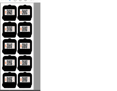

I need to prepare 1000 cards with variables data for everyone for printing
like this
thank you 🙂

 I know how to deal with variables with illustrator well
but my point on how to manage or prepare 1000 variables cards for printing?
like this
every 10 in one page like this automatically
thanks for your help 🙂
LEGEND ,
Oct 26, 2020 Oct 26, 2020
So you want to combine imposition and data merge, and the imposition part is giving the trouble? That does not seem to be how Illustrator is made to work.

Yea it can work this way, just make more columns of the same kind of variable such as "Name_1", "Name_2",.. "Name_5".
And in the next row it will be like "Name_6", "Name_7".
Here is a video by John Garrett:
https://www.youtube.com/watch?v=083kc84aSIc
Actually there's a un-mentioned VariableImporter script feature called the "interval" increments which helps with data-set naming of batch files like this.
I never wrote an article on this, but it's ready once I get around to putting it on Linkedin.
Here's a QR code article though which may have useful things such as the QR code script from someone else and instructions on how to use it in the batch action process. (https://www.linkedin.com/pulse/illustrator-variable-data-super-advanced-techniques-vasily-hall/)

Imposition (laying out multiple artworks to be printed all at once on a larger size of paper) is traditionally handler by the printing vendor, along with cutting/folding/binding the printed results. If you’re sending the artwork files to an outside printer, talk to them first.
Or are you printing them yourself on Avery-style labels, in which case you’ll want to lay them out to match the pre-cut sheets? If that’s the case, and the individual artworks are already generated using sequential file names, I would suggest importing those files in batches into an Illustrator/InDesign template and print from there. (You can often find free templates online, although they’re more commonly for Word.)
