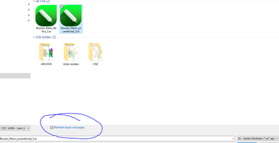

When you import an Illustrator document into CorelDRAW there is an option in the lower part of the dialog box that says "Maintain layers and pages" that can be checked or not. If it is not checked the Illustrator artwork will import on one layer.

Frank, take a close look at the attached screen shot of the Import dialog box from CorelDRAW 2023 (v 24.4.0.636):
I import layered Adobe Illustrator artwork into CorelDRAW on a fairly regular basis. The feature does work.

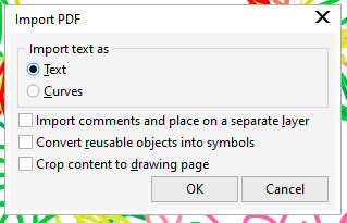

However no matter what it imports as a pdf.

OK, I'm confused. I thought you were having problems trying to control whether Illustrator AI files would import into CorelDRAW on a single layer or multiple layers. That seemed to be the context of your response to my comment from March of 2021.
The problem is the Illustrator art importing as PDF content? That usually happens when CorelDRAW is trying to import Illustrator files in a format too new for it to support.
Whoever is giving you Illustrator AI files needs to take a couple steps more than just hitting the "save" button when creating/saving the AI files. That just saves them in the latest version format. They're probably giving you files saved in Illustrator CC 2023 format with PDF compatiblity turned on. CorelDRAW can't import the AI 2023 data, so it reverts to importing the PDF data instead. That's better than nothing actually. If they unchecked the "Create PDF Compatible File" option in the Save dialog box you would end up with an AI file that would not import at all.
They need to click on the Save As command and under "versions" in the dialog box they need to choose an older "legacy format." Out of habit I usually choose version CS6 when saving AI files to be imported into CorelDRAW. The "Legacy CC" format delivers some hit and miss results.

Thank you Bobby, it seems that would be the problem, and also answers a question I had on why some ai files would not open because as you said "unchecked the "Create PDF Compatible File" option in the Save dialog box you would end up with an AI file that would not import at all.". BINGO!
These are curve drawings without any effects or fills but lots of curves in different colors. So perhaps your suggestion of saving as Legacy CC version CS6 would be no problem. I'll ask for that.
