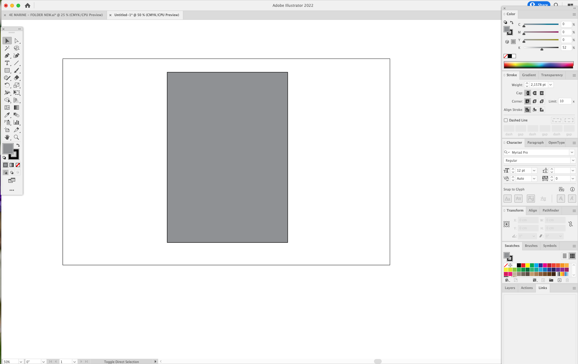

Hello everyone!
While working, Illustrator artboard partially disappears to white when moving around with HAND TOOL
Does anyone know why this happens?

I am have the exact same issue. I completly uninstalled illsutrator and am still haveing the issue.
I'm on an M2 macbook pro and OS is completly up to date.
