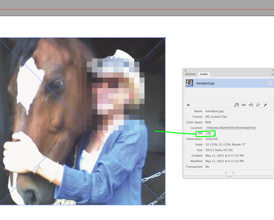

In your Links panel it will show the effective PPI of any placed image... like so:
 The traditional rule of thumb for printing is to have 300 ppi for images, but in reality, most people wouldn't even notice if it was half that. So, if the printer is simply "warning" you of an image below 300 ppi, you can safely ignore it if your effective PPI shown in your links panel is between 150-300. If your image has small text in it, you WILL want higher resolution, as text will not appear crisp otherwise.
You can always upsample lower-res images in Photoshop to a higher resolution, but this can come at the cost of blurring the image somewhat, which may actually make your final product look worse than if you left it alone.
