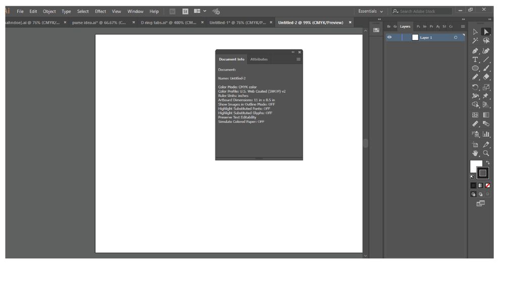

I go to the Window tab and then select Document info and I get a pop-up tab that looks nothing like this (the one I get says "Document info" on one side and "Attributes" on the other, and neither one has any inforation about the length of my stroke)... Is there "document info" located somewhere else as well?  Why does Adobe make this so difficult to locate? (I am not even looking for information about my "document," I am looking for a measurement for the length of a stroke).
Sep 22, 2022 Sep 22, 2022
Do you see the panel menu open in my screenshot? Open it and select 'Objects' instead of 'Document'.

Doug, help me out here.  I am looking at my Illustrator screen right now-- what do I click on to get that panel to open up?  What is it "under"?

Wait, no, I figured it out on my own: after choosing Document info I need to click on the little box on the upper right corner of the resulting pop-up (the "menu" icon) and then select Objects rather than Document.  Yeesh.  I am sure this could be easier to find, but it just ain't.  Thanks, though!
Well, nearly every panel has a menu. If you have no familiarity with the Illustrator interface, I'd suggest reading through the relevant parts of the manual before you start.
