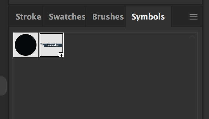

Hi all
I need a script to apply a Symbol to the end points of selected lines. Ideally this would function as follows:
1. Create Symbol called 'EndPoint'
2. Select lines
3. Run script that applies the 'EndPoint' symbol to the end of all of the selected lines
Any help would be much appreciated.
Cheers
Mike
I want to be able to select a bunch of lines and use a script to apply a symbol titled 'EndPoint' to the end point of all of the linesI want to be able to select a bunch of lines and use a script to apply a symbol titled 'EndPoint' to the end point of all of the linesHere's the Symbol titled 'EndPoint'Here's the Symbol titled 'EndPoint'Here's the end result I'm afterHere's the end result I'm after

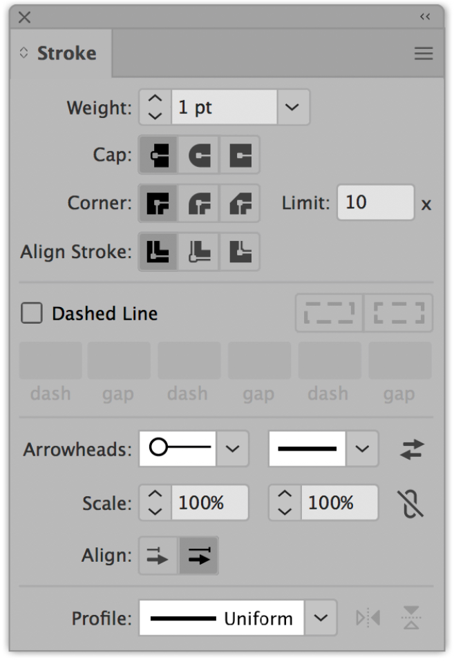

There is a pretty easy way to add a circle or shape at the end of your line using your stroke panel. Make sure "show options" is selected on the stroke panel so that you can see the arrow menus. Then you can select your line, and choose what arrow symbol endpoint you'd like to apply.
Feb 17, 2020 Feb 17, 2020
But we are obviously not just talking about a simple circle, meganchi. See the original request.
In case it does not necessarily have to be a native Illustrator symbol, I would do it with a Scatter brush. I've posted similar approaches in the past on this forum.
Advocate ,
Oh, goodness, my bad. Thanks for explaining to look at the original request, Kurt. Your advice is spot on.
