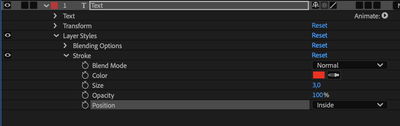

Sorry, came to this post with a Text object in mind, but further inspection shows that this thread is not about Text.
Still, for my project I need (editable) Text to have an inside Stroke. None of the Adobe CC apps can do it, for obvious reasons - it can turn out ugly and maybe will hang the apps, due to intersecting values. But I can think of an algorithm that can handle this.
For now I found a workaround with After Effects Layer Styles, but it is not the most convenient way:
