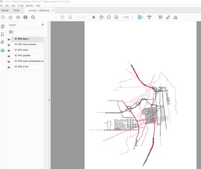

Hello there,
Sorry to re-open this thread, but I'm facing the same issue.
I exported (published) a PDF from Archicad, opened it in adobe acrobat and have acces to the layers structure.
Although, When I import (place) this in Illustrator, the layer structure isn't maintained....
I've seen many post but can't find the answer.
Help would be greatly appreciated 🙂
-Charles C.

New Here ,
Dec 03, 2024 Dec 03, 2024
2 years late but i had the exact problem and spent 30 minutes trying to figure it out - what worked for me was instead of trying to export the layers i went to organise the pages and extracted each page (mine was a multiple artboard problem). i opened the extracted pdfs on illustrator and the original layers were all there!!!
Explorer ,
Mar 19, 2025 Mar 19, 2025
Could you describe how you extracted the layers?? I have a map and i need the certain layers as a layer in illustrator....

New Here ,
Apr 08, 2025 Apr 08, 2025
hiya! when you open acrobat theres a button on the right side for the panel Pages. i clicked the 3 dots on the panel and then extract pages. then open the new extracted pages in illustrator - it should work if the file shows existing layers in acrobat!
No, it doesn't work. This was answered about 6 years ago and the answer hasn't changed.
