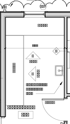

When I import certain PDFs in illustrator i get a cant't find text error and all the text displays like the picture below. i have tried adding the fonts to illustrator but that did not work
