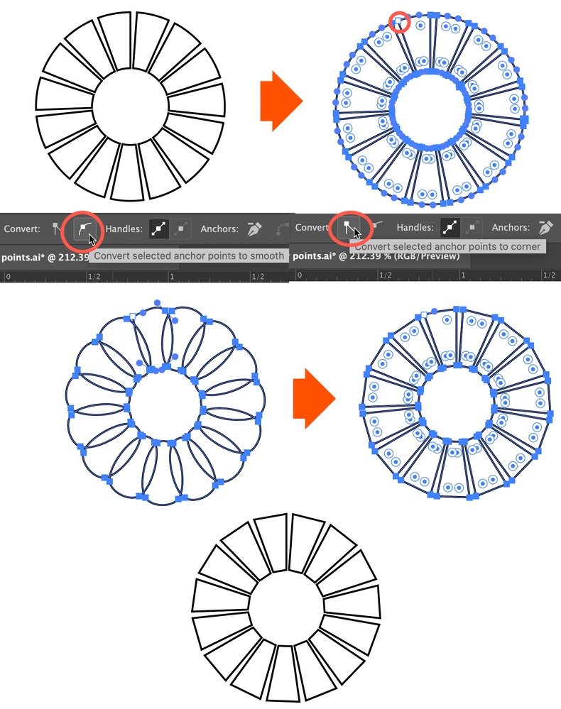

I have the same problem. I tried the select all - deselect one - convert suggestion, but it didn't work.
My document is comprised of a doughnut shape, divided into 365 wedge sections. Each wedge has 4 corners (so 1460 corners) I'm trying to convert all the corners of the wedges to handle free corners. When I try the suggestion above with a group of the wedges, only one or two of the anchors convert.

Apparently, at least in some circumstances, an anchor point with one handle is recognized by Illustrator as a corner point,  so it cannot be converted to a corner point,  The solution appears to be to convert the points to smooth points, then to corner points. Again, select all the paths but deselect one point. Click convert to smooth points, then click convert to corner points. Select the unconverted point and repeat the process.

Apr 23, 2021 Apr 23, 2021
Thank you! This worked perfectly. Thank you so much for the explanation and solution
