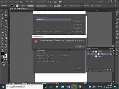

New Here ,
Aug 12, 2021 Aug 12, 2021
Can you please explain this in laymans terms on how to accomplish this so I have access to my fonts to finish setting up an SVG file for cutting on vinyl.
I have no idea about scripting or coding.  Please help me access my fonts.
error reads: Some text was on a locked layer and the font could not be replaced
