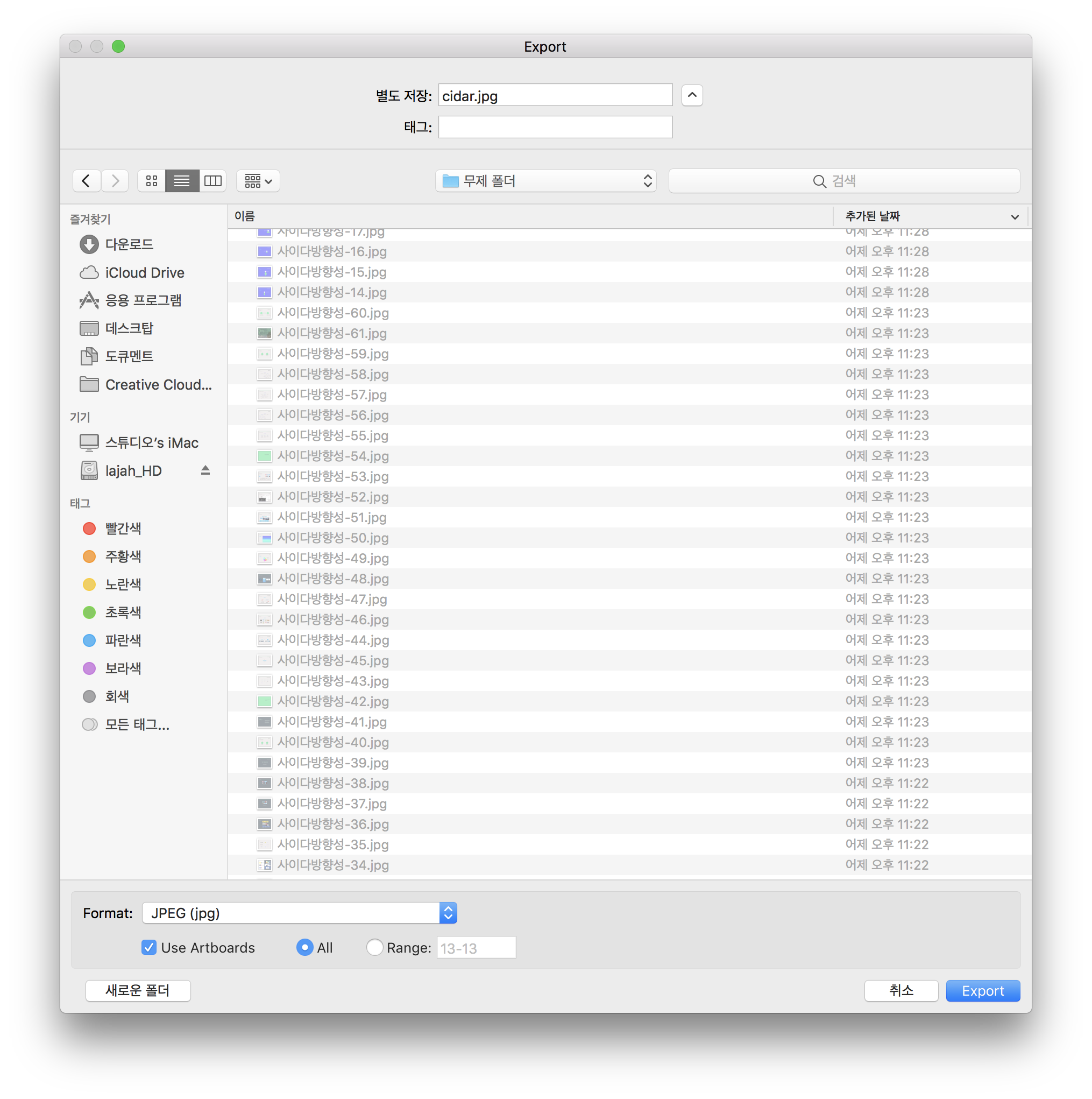

Do you use Use Artboards option?Share pls screenshots:
1. Your export settings
2. The final jpg properties (pixel dimensions)
3. If possible, the screen of your artwork (all artboards together) to clear what might happen here.

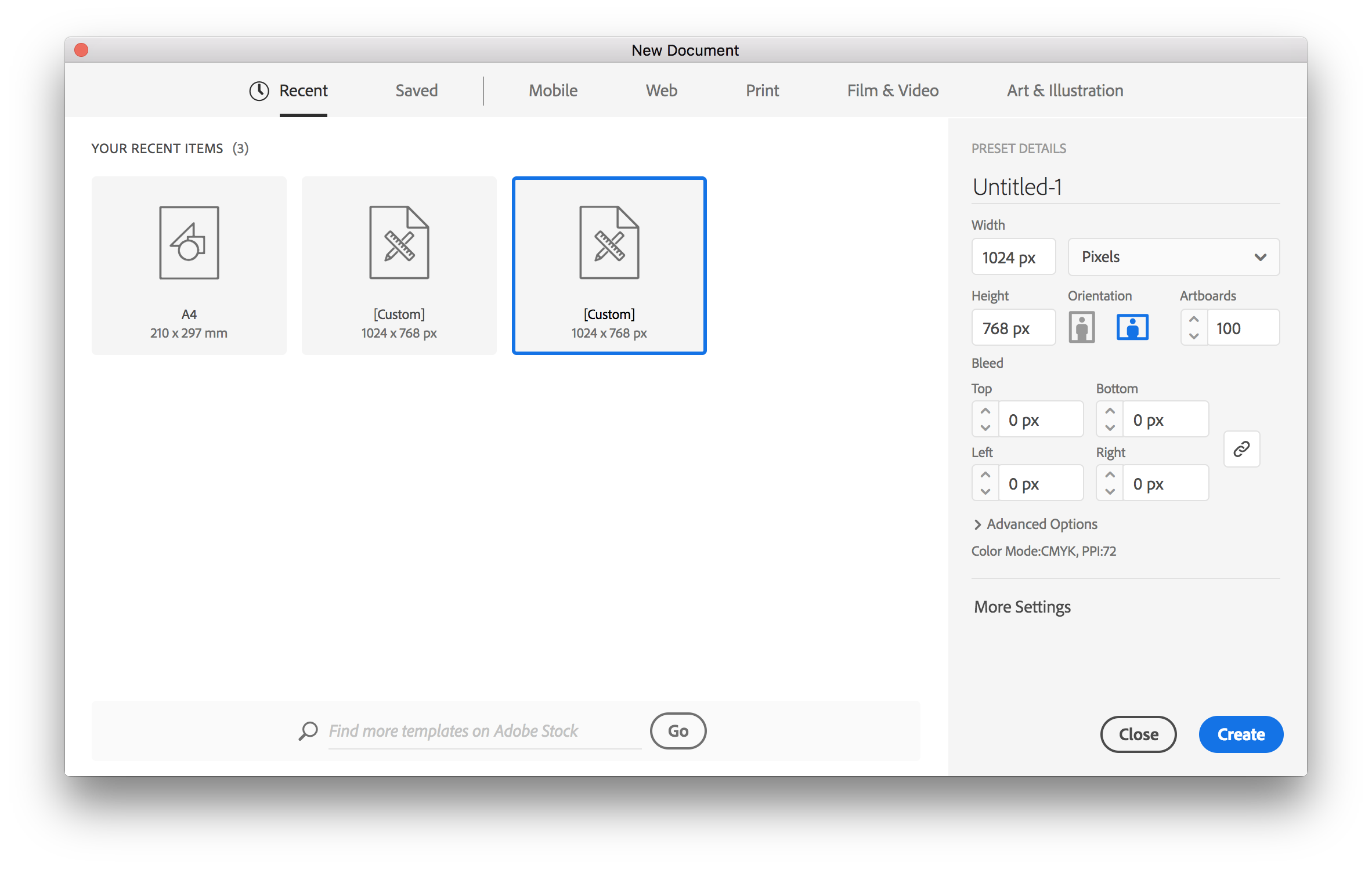

At first, I made several art boards with 1024x768 pixels.
Community Beginner ,
Apr 20, 2018 Apr 20, 2018
As shown above, export generates a different file size by one pixel. I don't know why it's the same art board size, but different sizes.
