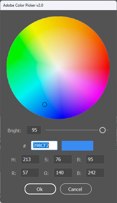

Thank you so much!!
I'm still baffled at how badly Adobe has documented their stuff (and the lack of tutorials they provide)!
Any idea where I could find the latest menu commands list (for Illustrator CC 2020)?
From your links and this post (https://community.adobe.com/t5/illustrator/get-menu-command-strings/m-p/8539169?page=1#M216220), I found a way to get the menu command:
(Explained here for future lost programmers 😉 )
1) Create a new Action set
2) Then choose "Insert Menu Item"
3) Search for the right menu item and add it to the action set.
4) Click "Save Actions" from the small menu in the Action panel
5) Open the saved .aia file in some text editor
6) Find the 'event', in my case it was under "/event-2 {"
7) In my case '/parameter-1' had a '/value' of "4c6976652041646f62652050534c20476175737369616e20426c7572"
😎 Convert that value from HEX to ASCII (I used: https://www.rapidtables.com/convert/number/hex-to-ascii.html) and get the menu command. In this case "Live Adobe PSL Gaussian Blur". (Which worked when used in Illustrator CC 2020.)
I still get the popup dialog with the options to adjust. So if anyone knows how to set these and skip the dialog, that would be awesome !
