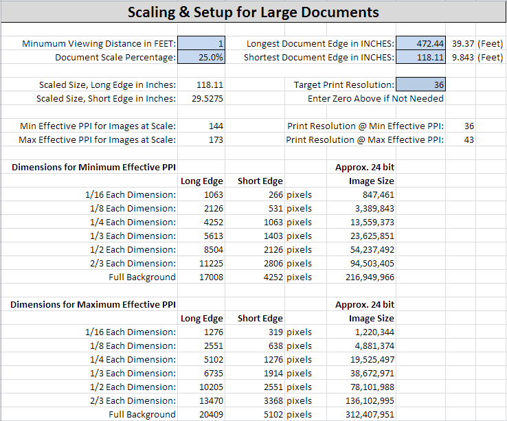

I have targeted 36 dpi effective resolution for billboards in the past, though I often go higher depending upon the images I require.
Your 2000 px wide image will hit 36 dpi effective resolution at about 1/8 of the artboard size. This may be fine for the image and design, I dunno.
The below is a screen shot from the spreadsheet I use for large format work. You can probably figure out what it is reporting for image sizes to hit the target effective resolution for the min/max dpi it calculates. And

Valorous Hero ,
Feb 24, 2017 Feb 24, 2017
The below is a screen shot from the spreadsheet I use for large format work. You can probably figure out what it is reporting for image sizes to hit the target effective resolution for the min/max dpi it calculates. And sorry, I still haven't gotten around to making a switch for metric versus the inches I use. But it's close enough of a conversion for this purpose.
