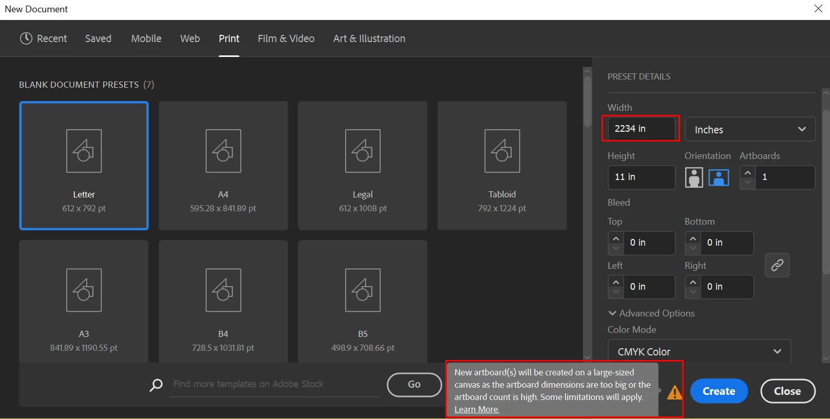

The latest release of Illustrator (24.2) comes with one of the most requested features, a larger canvas with 100x more space to keep all your assets organized in one project.
Now whether you need room to design or create wall art, billboards, advertisements, and more, you can expand your canvas area without worrying about the artwork dimensions, precision, and scale.
Illustrator 24.2 offers a canvas size of 2270 x 2270 inches which lets you create multiple artboards with larger dimensions. You can also use these updated units in the Units drop-down: Feet, Meters, Yards, and Feet & Inches.
To ensure that the new document is created with a larger canvas use the following settings in the New Document dialog:
  • Specify the artboard size of more than 227 inches (default canvas size). You can also choose the specified units in Feet, Meters, Yards, or Feet & Inches.
  • Large canvas allows you to accommodate more artboards than the default canvas size.
An alert sign is displayed at the bottom of the New document dialog indicating that the specified dimensions are bigger than the default canvas size and the new document will be created on a large canvas.
Check this link for more details about this feature.
