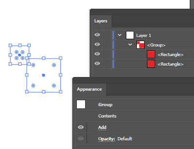

Here is working as we want, the Add effect is on top.
And here is how the liveeffect method applies the 'Add':
It erases the drawing, and when I expand my appearance (cause the color really doesn't matter, I am recoloring it anyways in my script), because all the drawing is gone, the entire shape disappears!

I see, I can replicate the issue.
I don't know why it behaves like that, but using executeMenuCommand works as it should
app.executeMenuCommand('Live Pathfinder Add');
