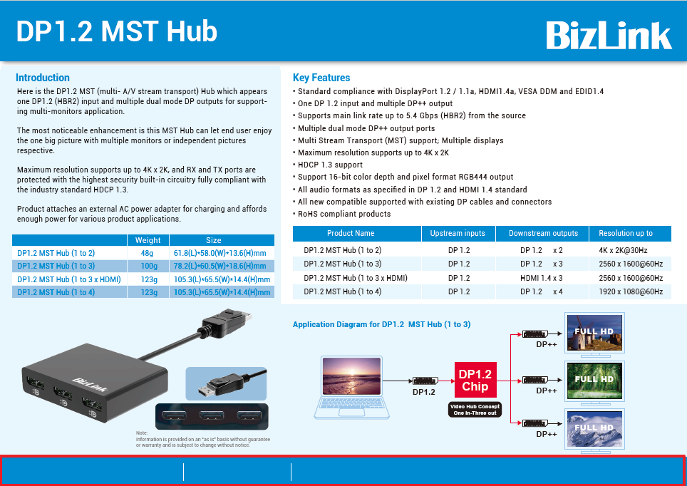

but after saving as a .pdf file, it lost some words by opening the file with adobe reader: ( see below red area)
My product version is Adobe CS6, how could I fix the issue? Thank you.

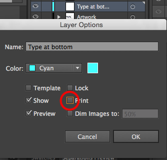

1) If the layer the type is on is set to not print.

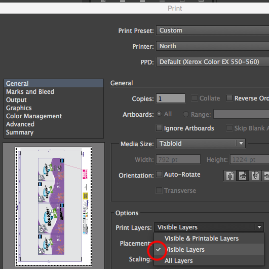

2) If the you have "Visible Layers" checked on the file. Changing to the first or third option would fix the creation of the pdf.
