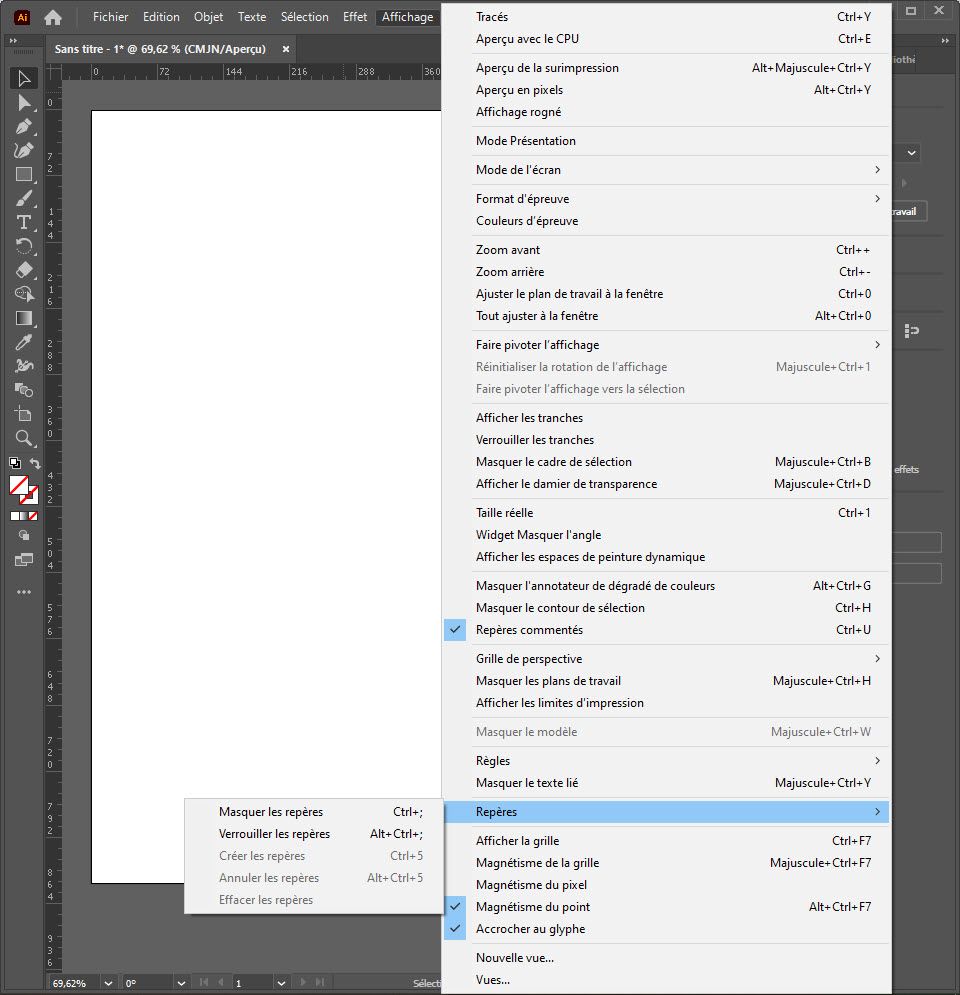

By default, in Photoshop, when you move a guide over the entire width, there is a pause that designates the precise center of a document thanks to magnetism. Same on the length.
I would like Illustrator to react in the same way, but I can't find the setting in question. I can find the different magnetisms in the "View" menu but despite my attempts, I can't understand which one corresponds to what I want.
I am using Illustrator 2023 version 27.6.1

Indeed, by dragging from the intersection of the rules while holding down the "Ctrl" key (under Windows), this creates a horizontal and vertical guide at the same time. All that remains is to move approximately towards the center until a small pink cross and the indication "Center" appear, to finally release the left click. Monika Gause's method also works and these two methods will be very useful to me!

You can draw a guide, select it and align it to the center with the align buttons.

If you have smart guides (repères commentés) on and you are very lucky, you should be able to see an indication of the center of the artboard when dragging a guide.
July 27, 2024
So I'm out of luck lol
The commented markers feature is checked, and I've reset the preferences and settings to default, but nothing happens.

Besides being very lucky, I did it while dragging from the intersection of the Rulers while holding down the Cmd (Ctrl on Windows) key. This creates a horizontal and vertical guide at the same time. With a single guide, I could not get it to work.
It is faster and easier to drag a rectangle that has the same size as the artboard and drag the guides to the center.
