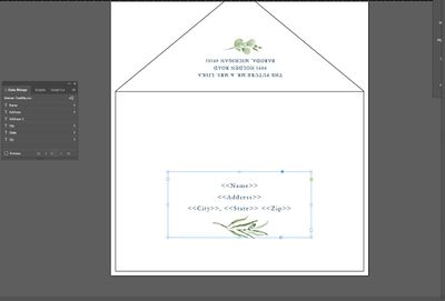

If I did multiple text boxes that could work with the 1st line for the envelope which is the "name" field, the 2nd address line field but how would that work with the 3rd line?...which needs to be "City" with a comma after, then "state" then "zip"  (all on one line like a typical envelope address....and since each word is a different length based on how many letters are in each city name or state that changes the length of the line, where the comma falls & these lines needs to be centered line over line, not flush left. What program would I need to use to make that happen? Does In-Design work for that? or is there a script for Illustrator I could download & import/install?

Do you have a screenshot of the artwork in question by any chance? I'm just curious to see if a script could be developed or if any native solution would serve as some workaround.

Here you go...hope this helps. I actually just changed my Adobe CC account to add InDesign & it's working BEAUTIFULLY!!! I think I like InDesign waaaay better. I'm more text based anyway vs graphics based. I do like having both because of the flexibility with vector images in Illustrator but InDesign just made this "mail merge" a BREEZE!!! Holy moly...what a difference.IllustratorIllustratorInDesignInDesign
Valorous Hero ,
May 15, 2020 May 15, 2020
Oh yes, InDesign does best with the text!
