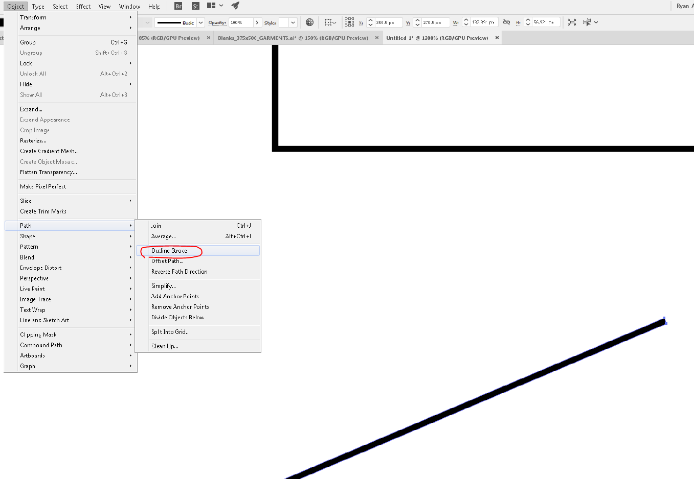

I would go with @Monika Gause 's approach.. and if you don't want to redraw your strokes as rectangles I would recommend select them all and outline them so they turn into shapes.
