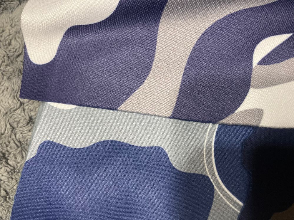

I created an image for sublimation using a specific pattern swatch on illustrator. It required printing more than 1 component, so to save paper I added the other component to a different artboard on the same project using the same pattern swatch as the other component, but after I printed them out the second component (artboard 2) came out a noticeably darker shade than the first component (artboard 1). This has happened multiple times and I can't figure out why but is there a chance that the artbords are printing in different formats? Like one is printing in CMYK and the other is printing in RGB or vice versa, by just adding anither artboard? I'm printing using an Epson F570

I have not tried the save a copy option yet, But I hear you about the conspicous files. Let me try posting the images this way, thanks.IMG_7591.jpegIMG_7575.jpeg

Thank you, DrDre, much easier to see them together.
The reason for my suggesting the PDF, I forgot to mention the important bit of printing from Acrobat, is that the F570 seems to have no PostScript (emulating) driver, so printing straight from AI can give issues.

Ok, thank you. I will now look up what post script is, lol. So are you saying I should save the work as a pdf and then print the work not using AI? I did try this and although the colors do match the same with each other, they were off as it relates to the final result of print as compared to what they should have origionally looked like.
