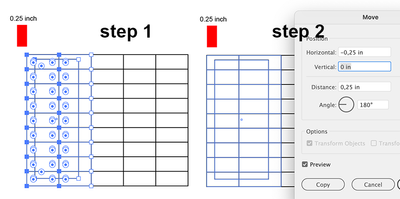

I thought this was what I was looking for but I'm not sure it's quite it. I'm looking for the best way to easily adjust individual points on an illustrator shape using specific dimensions or measurements. For example, I am making a sewing tech drawing but need to adjust one of the edges to be 1/4th inch longer. I don't want to adjust the whole shape, because it will adjust certain points that need to stay in a specific position. I usually manually adjust the coordinates by using my calculator to add or subtract the difference and imput that number into the transform panel, but that it very time consuming. Do you know of anything that would help here? Thanks!
Sergey Osokin
June 6, 2023
Can't you just select the right path points with a Lasso tool, for example, and run the Move panel?
pixxxelschubser
June 6, 2023
@babynoogz
or simple write in the control bar (x or y coordinate) your desired value after the current value - in your case: +1/4 inch
