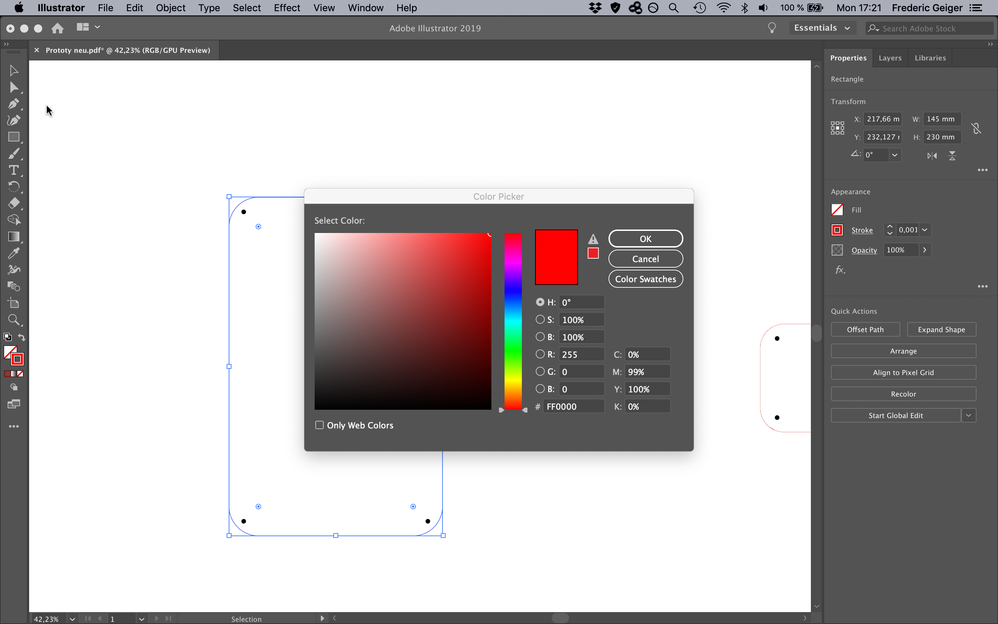

Your RGB red is OOG for CMYK.
But it is a perfectly valid in Gamut RBG color, so do not click the warning.
Do you need CMYK red?

This is what it looks like.

But if I don't click the warning and send it to the laser via File>Print, JobControl does not recognize the RGB red (255/0/0)
Oct 28, 2019 Oct 28, 2019
Then maybe it's time to talk to that company about their printer driver.

"Also, the out of gamut error wasn't there till today and I don't understand why it would show me this error in the RGB document color mode."
That warning has always been there when you use color management.
Maybe your Color Settings turned off Color Management in the past (Emulate Illustrator 6)?
